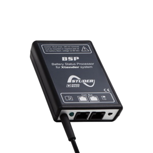

| bsp | For BSP that offer a highly precise measuring for Xtender, VarioTrack and VarioString systems | ![]() |

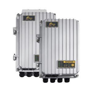

| variotrack | For the VarioTrack models of MPPT solar charge controllers for systems with solar PV capacity from 1 - 75kWp | ![]() |
